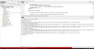

Hi, Amanda Hsieh,
I am trying to program the device with SDK16_ble_app_att_mtu_throughput.zip but getting the following error.
Here is directrory ofproject: C:\Nordic\SDK\nRF5SDK17009d13099\nRF5_SDK_17.0.0_9d13099\examples\peripheral\ble_app_att_mtu_throughput
Need your help, please?
