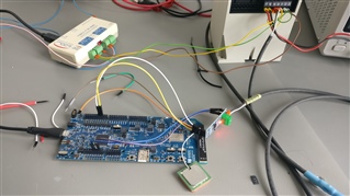

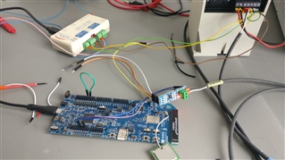

    For trial, I tried to change my tx,rx,rts,cts pins to 10,11,12,13 respectively and then put a loopback between 10 and 11 (tx and rx) just to see if it is being transmitted. I see this output:
    I want to transmit this ""AT,test" through my Tx externally. I see that the loopback works. My connection to check the loopback is:
    My connection to transmit to external is:
    My external communication is to a ASCII string capture console and I have a TTL_485 converter in between. I am trying to use your project to try and send the strings out. When I remove the loopback and connect externally, I dont see the "AT,test" either on my PC console or my ASCII capture console.
    What could I be doing wrong here ? Any leads would be appreciated :). Thanks for the time.
    Adeel.
  • Hello again!
    Good that the loopback works. Then the problem is not (directly) with the code at least.
    I guess the issue is then related to your wiring/module, but I'm not familiar with the module you are using (or RS485). However, could you try switching around your connections so that rx(P0.10) -> RO and tx(P0.11)->DO and see if that helps?
    In addition, I believe and RE/DE are required to enable receive/transmit? Maybe you need to control that from the nRF9160 somehow. I found a case that did something similar to you, so you could have a look at that.
