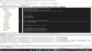

NRFX_TWIM0_INST_IDX' undeclared and configuration problems
Hi to everyone!
I am working on the SDK 17.0.2 and my project contains nrfx_twim.h functions.
I have a problem to understand the changes that i have to make in the sdk_config.h. I have already read all the posts about these concerns but i found small differences in the sdk_config.h of this SDK that do not let me understand the right updates to make in my case.

  • HI, sorry but i cannot understand. that's my fault because i am new to this architecture and i am in seriuos trouble with my project.
    For example the first post is referring to set PPI_ENABLED 0 and NRFX_PPI_ENABLED 1. where i can find this macros? i have to add them up manually to the sdk_config.h? i have done it but in apply_old_config there is no change at all.
    what am i missing?

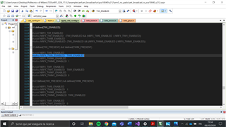

    Try adding the following to your sdk_config.h file.
    // </e>
    // <e> NRFX_TWIM_ENABLED - nrfx_twim - TWIM peripheral driver
    #ifndef NRFX_TWIM_ENABLED
    #define NRFX_TWIM_ENABLED 1

    Please also make sure that you do not have TWI_ENABLED defined in your sdk_config. To be explicit: It can not be set to 0, it needs to be commented out or removed all together, if you have added it already.
    Try this, and let me know if your original NRFX_TWIM0_INST_IDX undeclared error is resolved.

  • Unfortunately the error is still there. The only TWI_ENABLED in my project are these:

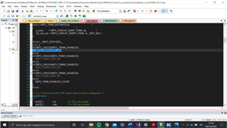

    Sorry, it seems that I enabled TWIM1 in the configuration I sent you, and you are creating an instance for TWIM0.
    Please change NRFX_TWIM0_ENABLED to 1, and NRFX_TWIM1_ENABLED to 0, and see if it resolves the error.
