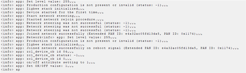

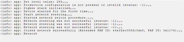

    While Debugging this example I'm facing a new problem now:
    The debugger connection gets lost while doing ZigBee related things and eval board seems to reconnect itself.
    In the beginning this seemed to be directly related to ZigBee Events (after connection, when trying to change level).
    Now I cannot regularly reproduce it so it might also be related to sth else. During debug without touching the board the SES displays "Target connection has been lost" and the board reconnects (the virtual storage device pops up again and terminal on com-port is lost). Other times SES just hung up with no response until I disconnected the board manually.
    I thought it might be a power supply related thing but the board is set to SW9 VDD which should work fine?
    The attached screenshot shows where this happend the first and second time from the view of the serial ouput.
    Lost connection shortly after being discovered by Hue:
    Restarted the debugger and reconnected automatically to Hue - trying to enable/disable light and got lost again:
    This is all SES is saying:

  • Hi Alex,
    I haven't seen a problem where Zigbee events cause lost connection before, so I' might need some time to figure out what the issue can be.
    Since SES is displaying that the target connection has been lost, the problem seems to be with the JLink connection. Is this only happening with one board, or do you see the same thing with different boards? Have you tried using different cables to connect the board? The problem can simply be faulty hardware.
    Marte
  • Hi Marte,
    Thanks for your advice. I changed the usb cable to a shorter and higher quality one and the issues seem to be gone now! I did not spend too much time using it but it looks stable for now.
    Alex
  • Hi Alex,
    Great to hear that it's working as expected now!
    Please don't hesitate to ask if you have any other problems.
    Marte
