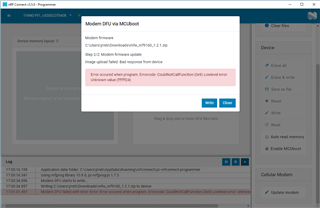

Error updating firmware ( Errorcode: CouldNotCallFunction (0x9) Lowlever error: Unknown value (ffffff24) )
When I try to update the modem firmware I get this error Errorcode: CouldNotCallFunction (0x9) Lowlever error: Unknown value (ffffff24). See attached picture bellow:
Before anyone asks: Yes I have pressed the MCUBoot button during power on of the device.
I've read some other forum posts and you suggested that it was some J-Link driver problems? I then tried to uninstall and reinstall both the nRF Connect and J-Link drivers, but with no luck - it still doesn't work Disappointed
So what should I try next? Bellow is the log file, but there you won't find much more information about the error.

2020-10-08T15:00:34.856Z INFO Modem DFU starts to write...
2020-10-08T15:00:34.857Z INFO Writing C:\Users\jrreb\Downloads\mfw_nrf9160_1.2.1.zip to device
2020-10-08T15:01:01.491Z ERROR Modem DFU failed with error: Error: Error occured when program. Errorcode: CouldNotCallFunction (0x9)
Lowlevel error: Unknown value (ffffff24)
I am using Thingy:91 version 1.0.0. and am trying to update do firmware version 1.2.1. J-Link driver version is V6.86.
Thanks for reading and best regards.
