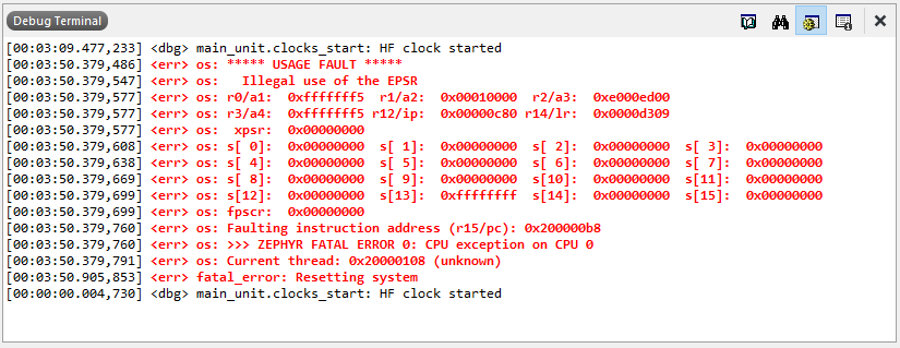

I'm trying on the ESB examples in nRF Connect SDK v1.3.1, but it seems the Zephyr is crashing during the call k_sleep (l. 54). The following code I isolate the "k_sleep" in a thread to pinpoint the source.
I'm using the PCA10040 board.

During debug the firmware is trapped in "z_arm_exc_spurious" handler. The log shows:
I tried several stack sizes and priorities for the new thread, but the crash persisted.
Did someone experiment this behaviour before?
