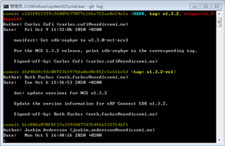

AT+CFUN=0/AT+CFUN=4 is not confirned with "OK".(NCS1.3.0)
I add lte_lc_init_and_connect() to the application "Serial LTE Modem" (SLM) v1.3.0. And then there's no reaction to AT+CFUN=0 or AT+CFUN=4.

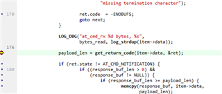

I find that the socket_thread_fn() in at_cmd.c does not respond "OK\r\n".
It returns "+CSCON: 1\r\n" and  "+CEREG: 0,"1D2C","0D61D950",9,0,0,"11100000","11100000"\r\n"
So no messages are put on the queue. The program is blocked at_write().
static inline int at_write(const char *const cmd, enum at_cmd_state *state)
	int bytes_sent;
	int bytes_to_send = strlen(cmd);
	struct return_state_object ret;
	LOG_DBG("Sending command %s", log_strdup(cmd));
	bytes_sent = send(common_socket_fd, cmd, bytes_to_send, 0);
	if (bytes_sent == -1) {
		LOG_ERR("Failed to send AT command (err:%d)", errno);
		ret.code  = -errno;
		ret.state = AT_CMD_ERROR;
	} else {
		LOG_DBG("Awaiting response for %s", log_strdup(cmd));
		k_msgq_get(&return_code_msq, &ret, K_FOREVER);   //It's blocked here
		LOG_DBG("Bytes sent: %d", bytes_sent);
		if (bytes_sent != bytes_to_send) {
			LOG_ERR("Bytes sent (%d) was not the "
				"same as expected (%d)",
				bytes_sent, bytes_to_send);
	if (state) {
		*state = ret.state;
	return ret.code;
