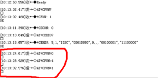

    You didn't understand the problem I described. I just added  lte_lc_init_and_connect()  before "ready" to let it network automatically.
    The default SLM program requires manual network injection and this bug does not occur.Here is mt log:
    When I add lte_lc_init_and_connect(), the network is done before "ready". You can see the 128 lines of main.c code above, only added lte_lc_init_and_connect(). Here is my log:
    before "ready":
    after "ready":
    The program in red is blocked.

    I am able to reproduce the issue at my side now as well, I have tried to find a workaround that would work with using the LTE Link Control library, and it seems to be affected by the +CEREG notification response.
    A workaround for this issue is to disable the CEREG notification, by sending the command AT+CEREG=0.
    Then you should be able to Turn OFF and ON the modem without any issues.

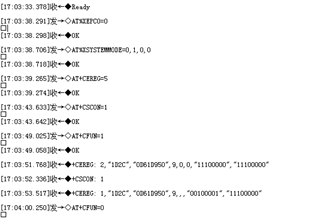

  • Hi:
    I tried it your way and found that the problem should be affected by the +CSCON notification response.
    You can look at the following four scenarios.
    When LTE goes into idle state, the bug reappears.
    Normal when LTE dose not idle and sends the command AT+CEREG=0.
    The default SLM program with CSCON enabled also replicates this problem.
    No other problems occurred when the CSCON notification was disabled.
    Thank you for your answer. I only find this problem exists in SLM. Please let me know if you have a good solution.
    Thank you for the additional observations and feedback.
    I can replicate what you are seeing as well so we are working on this internally to see what we can to solve this.
    Hopefully this workaround is sufficient for you as of now.
    If not then I would recommend setting up the modem "manually" with the AT commands to avoid the issue entirely.
