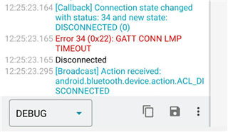

And if I run this example and connect with the app, the connection will be lost in about 30 seconds, so can you tell me why?
Thank you.
    Check the return code of `ble_nus_data_send` and see if you get any error.

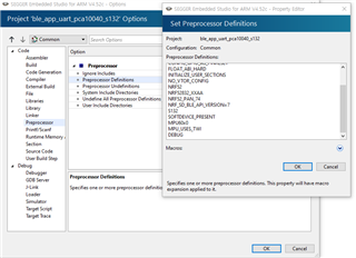

    Define DEBUG in preprocessor symbols debug your application as showed here and here.
    What reason is showed in nRFConnect app while disconnect happens?

    I defined DEBUG and proceeded debugging.
    However, the message is not printed on Debug Terminal.

    And I checked the messages that were printed when the Bluetooth connection was lost.
    Can you tell anything in this error message?
