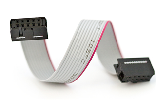

Otherwise, if I need to use a hardware programmer, could you point me to the right (and cheapest) one (including the right cable), for example on DigiKey or Mouser?

    The cheapest solution for an external debugger is maybe to get an nRF91DK, there you can use the debug-out port connected to a simple 10-pin connector as such:

  • Hello Martin,
    I received my NRF9160 DK and immediately flashed the modem and application to the Thingy:91.
    Based on the messages and log (see below) everything seems to have worked fine, but after the flashing the Thingy still looks like not switching on or doing anything.
