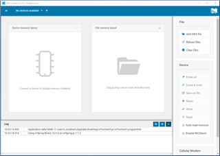

    Open the Programmer application, it looks like this:
    In the top left corner you can se the No device available tab
    This will change to Select device when you have connected the Thingy:91 to your computer with a USB cable.

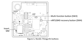

    NOTE: before plugging in the Thingy:91 remember to hold SW3 while turning on the device.
    Here is a more detailed description of how to connect the device to you computer when programming the modem or the application core.

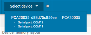

    Now select the Thingy:91, it should look like this when it is available to be selected.
    and it looks like this when it is selected, note the dot on the side changes from grey to green

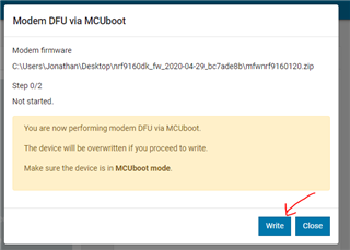

    Click the Update modem button down in the right corner.(see picture)
    Then navigate to where you have the Thingy:91 application an modem firmware folder located and select the file with the name mfwnrf9160120.zip.
    Then click Write on the Pop up box.
    Make sure that the Thingy 91 is in MCUboot mode.

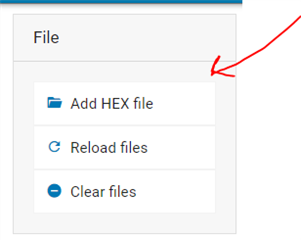

    The process is the same as when updating the modem firmware but click on the add hex file instead.
    Locate the files you downloaded and select the images_dfu_hex folder. Inn the video above they show the asset tracer example, I will explain the at client example here in text.

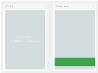

    Find the file called thingy91_at_client_dfu_2020-09-23_b6ad40d0.hex from the folder, a green block should be located in the file memory box like this:
    You can now click write and then click write on the pop up box.
