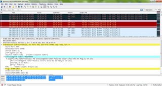

Also attaching the modem trace collected using "NRF Trace Collector" and enodeb trace collected by our network team.
Please see the attachments.

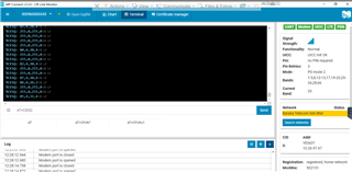

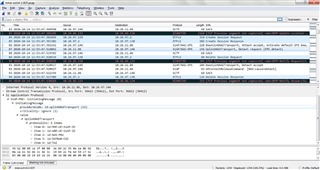

  • Yes! The carrier changed the parameter to the default as per spec and now able to connect to the NB-IoT network. Attaching the final log and trace for reference.
    Thanks a lot for the support
     trace_working.zip
    2020-10-20T04:30:49.997Z DEBUG modem >> AT+CGDCONT=0,"IP","yesiot"
    2020-10-20T04:30:50.156Z DEBUG modem << OK
    2020-10-20T04:31:06.762Z DEBUG modem >> AT%XSYSTEMMODE=0,1,1,0
    2020-10-20T04:31:06.792Z DEBUG modem << OK
    2020-10-20T04:31:08.826Z DEBUG modem >> AT+CFUN=1
    2020-10-20T04:31:08.997Z DEBUG modem << OK

  • We are getting another issue now. We are able to connect to Nb-IoT network Malaysia , but when tried HTTPs connect with our custom server ( ipv4 address ), the connect is getting failed.
    The socket connect function ( connect() in socket.h ) is returning -1.
    The wire shark logs are attached. Can you please help us in understanding this issue ?
    Another observation is when server address is ipv6 , we are able to connect via HTTPS. Issue is seeing only with ipv4 address. However network have support for both ipv4 and ipv6.
    Also we verified our custom server with ipv4 address independently using another LTE-M SIM. ( Tested the same application code with a different LTE-M network and SIM).
    Below is the wire shark log collected when HTTPs connect is failing.
