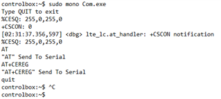

I have one problem more. With my .cs Script I am opening a USB Port on my Raspberry, to communicate with my Nordic Thingy 91.
I can Read what the Nordic is sending to me, but if I tried to send a command, no result came back.
The .cs line is:
string command = "AT";
_serialPort.WriteLine(command);
As result I expect "OK" from my thingy  -
my Read() is a Thread. Therefore I should not miss a Line that the Thingy is sending to me, right?
My Baud Rate is 115200 and I set RTS = false and DTR = true.
In this img you can see my results, by communicating with the Thingy. - I have tried to send AT and AT+CEREG but no responding from the device.
So does anyone know what I can do to fix it?

    How are the AT command terminated?
    Depending on which NCS version you are using, the at_host library (if that is what you are using) expects AT commands to be terminated with either a line feed ('\n') or carriage return ('\r').

  • I use the at_client.hex file and tried to terminate the command with the following methods:
    -ReadLine(command);
    -serial.Write(Environment.NewLine());
    (eol is end of line statement LF / CR / \n )
    -serial.Write(eol, 0, eol.Length)
    If you have an Idea for another EOL-Statement, please let me know.
    Do I have to open the second Port with 1000000 baud rate? - Cause I only opened the first one with 115200.
    In Putty I can use only one port and I can send and receive data.
     That port is primarily used for taking modem traces. You should not need to open it if you are not taking a modem trace.
    What application are you running on the Thingy?
    Could you try to enable logging in the at_cmd and at_host libraries by adding the following lines in the prj.conf file of the project (if you are using SES to build the application, you must re-open to project for the changes to take effect)?
    CONFIG_LOG=y
    CONFIG_AT_CMD_LOG_LEVEL_DBG=y
    CONFIG_AT_HOST_LOG_LEVEL_DBG=y
    If it works as expected when you are using Putty, but not your script, then the error is probably in your script, or the serial library you are using.
