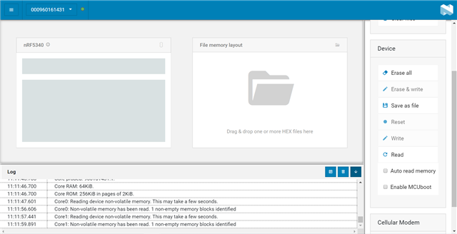

  • Hi. I found the solution to this problem.
    The nrfjprog is not updated to the latest version when SDK connect is downloaded.
    So I have downloaded the latest nRF Command Line Tools. Then, I checked the version of nrfjprog.
    It should be 10.10.0. Previously, it was 6.xx.xx.
    Then I tried the recover command.
    Then, I went to nRF Connect Programmer.
    Then I connect to device and read.
    The device is recover successfully.
