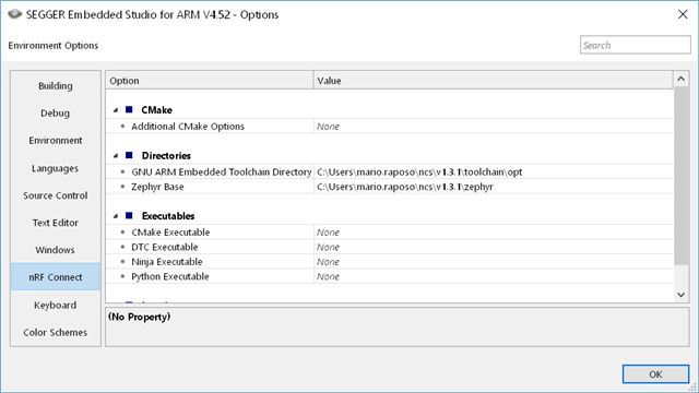

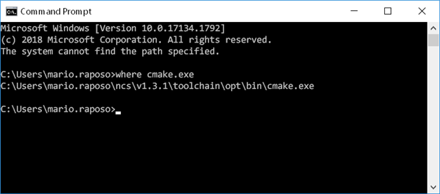

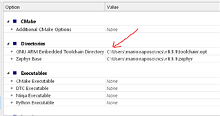

  • Uninstalled my installed cmake.
    Uninstalled NCS.
    Re-installed using Toolchain manager.
    Same error.
    Compiling the C compiler identification source file "CMakeCCompilerId.c" failed.
    Compiler: C:/Users/mario.raposo/ncs/v1.3.1/toolchain/opt/bin/arm-none-eabi-gcc.exe
    Build flags:
    Id flags:
    The output was:
    1
    c:/users/mario.raposo/ncs/v1.3.1/toolchain/opt/bin/../lib/gcc/arm-none-eabi/9.2.1/../../../../arm-none-eabi/bin/ld.exe: c:/users/mario.raposo/ncs/v1.3.1/toolchain/opt/bin/../lib/gcc/arm-none-eabi/9.2.1/../../../../arm-none-eabi/lib\libc.a(lib_a-exit.o): in function `exit':
    exit.c:(.text.exit+0x2c): undefined reference to `_exit'
