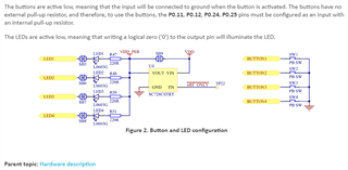

Anyhow, have you studied the relevant section in the Product Specification:
https://infocenter.nordicsemi.com/topic/ps_nrf52840/gpio.html?cp=4_0_0_5_8
Also the DK deocumentation:
Note that it tells you the buttons are active-low; ie, pressing a button takes it low - not high.
