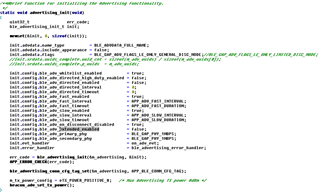

hi,
I am using nrf52840 (in a Laird module) and trying to advertise such that legacy BLE 4 mobile devices can connect. Only BLE 5 mobile can see the device (running nRFConnect).
I have set PHy on primary and secondary to 1MBs-1 and disabled extended advertising. Is there anything else I ned to do?
Code excerpt is below.. SD is S140
