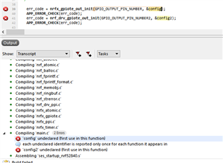

  • I can't compile the project. Where do you declare/define config and config2?
    Please try to unzip the project in an unmodified SDK before you upload it. It is a simple way to check that you didn't do any changes outside the project folder.
    BR,
    Edvin
  • Hi Edvin,
    Sorry for the delay. Can you check into the code and see what is missing. I think I am not properly assigning the address to PPI channel.
    gpiote.zip
    kind regards,
    Adarsh
    First of all you should be careful when you call APP_ERROR_CHECK(err_code) on an err_code that has not received a value, like you do in led_blinking_setup(), right after the lines:
    nrf_ppi_channel_t ppi_channel;
    and
    nrf_ppi_channel_t ppi_channel1;
    I am not sure exactly what you have been trying to do. Did you intend to use:
    nrf_drv_gpiote_out_config_t config1 = GPIOTE_CONFIG_OUT_TASK_HIGH;
    nrf_drv_gpiote_out_config_t config2 = GPIOTE_CONFIG_OUT_TASK_LOW;
    Remember that one of them will set the pin low, and the other will set the pin high.
    another thing:
    nrf_drv_timer_compare(&timer, NRF_TIMER_CC_CHANNEL0, (ticks_RED/2), true);
    nrf_drv_timer_extended_compare(&timer, NRF_TIMER_CC_CHANNEL1, ticks_RED, NRF_TIMER_SHORT_COMPARE0_CLEAR_MASK, true);
    You set CC0 shorter than CC1, and you reset the timer on CC0 (Compare0_clear_mask). Change it to NRF_TIMER_SHORT_COMPARE1_CLEAR_MASK, if you want the timer to count to reach CC1 = ticks_RED.
