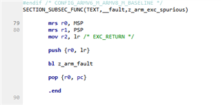

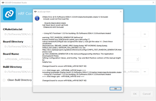

How can I link fw_info.h in SES for debugging nRF9160Dk
Whenever I try to debug my code, it gets stuck at fault_s_S as shown below
I experienced that one of the possible solutions to avoid this is to browse fw_info.h when the debugger asks for it. But it only asks sometimes and I believe that there must be a internal setting where I can link it.
