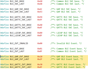

    There isn't a single list containing all of these, but if you open the file ble_ranges.h (search for BLE_SVC_BASE in one of the ble_app_... projects), you will see a list of the bases for the events. Let us say you want to find out what event the 0x12 event is. In that case, look in the ble_ranges.h file, and you will see that there are these defines:
    #define BLE_<something>_BASE
    #define BLE_<something>_LAST
    Check which one of them that wraps around the value you are looking for. In this case, that would be:
    #define BLE_GAP_EVT_BASE 0x10
    #define BLE_GAP_EVT_LAST 0x2F
    Then search for BLE_GAP_EVT_BASE in your project, and you will see a lot of occurrences in the file ble_gap.h.
    The enum BLE_GAP_EVTS contains all the events between BLE_GAP_EVT_BASE and BLE_GAP_EVT_LAST. In this case:
    BLE_GAP_EVT_CONN_PARAM_UPDATE           = BLE_GAP_EVT_BASE + 2 = 0x10 + 2 = 0x12.
    Likewise, 0x36 refers to BLE_GATTC_EVT_READ_RSP and 0x57 refers to BLE_GATTS_EVT_HVN_TX_COMPLETE.

  • Thank you Edvin! This was quite helpful.
    I notice that for the above codes you helped me translate, the enums listing the specific evt offset from the base live in files corresponding to the event base name. E.g., from highlighted section below, BLE_GAP_EVT_BASE --> ble_gap.h --> BLE_GAP_EVTS
    However, the enum corresponding to some of these other bases are not as findable. For example, BLE_EVT_BASE --> searching for BLE_EVT in "Entire Solution" does not seem to yield any equivalent results.

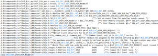

  • Thanks again Edvin.
    I get these results for BLE_EVT, but none of them seem quite right (no enum in results):
    and yes, I am using Segger. Let me know if I should be searching in a different way, I use the "ctl + shift + f" method.

  • Make sure that you have ticked of the correct boxes in the ctrl + shift + f window:
    If you create your own service, it will use the already existing events. Look at how this is done in e.g. the ble_app_uart example. This uses a custom service, and has it's own events in the nus_data_handler() in main.c, such as the BLE_NUS_EVT_RX_DATA event. This is an enum (0 indexed), but you can see how the BLE_NUS_EVT_RX_DATA event is generated in ble_nus.c's on_write() function, which is called in the ble_nus_on_ble_evt() callback whenever the BLE_GATTS_EVT_WRITE event occurs. The BLE_GATTS_EVT_WRITE event is a softdevice event (=BLE_GATTS_EVT_BASE = 0x50).
    Edvin
