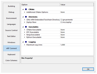

    Zephyr was unable to find the toolchain. Is the environment misconfigured?
    Make sure you have sett you environment variables correctly.
    In SES go to Tools>Optrions>nRF Connect and add the correct path to where you have your path's.

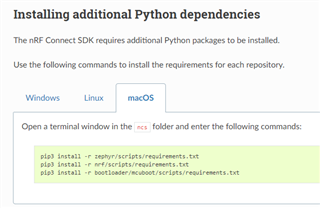

    I have found posts on DevZone that talk about installing the requirements using pip3, but this has not solved my problem. Here is the specific line from those logs pertaining to 'yaml':
    Requirement already satisfied: PyYAML>=5.1 in /usr/local/lib/python3.8/site-packages (from west>=0.7.2->-r scripts/requirements.txt (line 6)) (5.3.1)

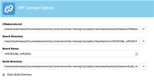

  • Hi Jonathan,
    I'm using SES Nordic Edition to open a nRF Connect SDK Project. Would you suggest using the terminal instead?
    I was able to run a west update in the NCS folder, but I received the same error about missing YAML when I tried opening a project in SES.

    No I don't recommend using terminal instead unless you want to tinker quite a bitt more to get it working.
    Here is a link to the documentation, Click on the master link to see the latest NCS updates. Here is a link to the getting started with nRF connect for desktop where you can find the steps to follow the setup for mac. Was it this you did?
    Note that for Mac and Linux the Getting started assistant is the guide to follow.
    To change the version to the one you are using click the triangle next to version number.
