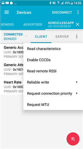

When I tab the connect button in nRF Connect app, nrf52840 starts to bond, it prints the following message:
<info> app_timer: RTC: initialized.
<info> app: LE Secure Connections example started.
<info> app: Scanning
<info> app: Advertising
<info> app: PERIPHERAL: Connected, handle 1.
<info> app: PERIPHERAL: BLE_GAP_EVT_SEC_PARAMS_REQUEST
<info> app: PERIPHERAL: BLE_GAP_EVT_LESC_DHKEY_REQUEST
<info> nrf_ble_lesc: Calling sd_ble_gap_lesc_dhkey_reply on conn_handle: 1
<info> peer_manager_handler: Connection secured: role: Peripheral, conn_handle: 1, procedure: Bonding
<info> app: PERIPHERAL: BLE_GAP_EVT_AUTH_STATUS: status=0x0 bond=0x1 lv4: 0 kdist_own:0x3 kdist_peer:0x2
<info> peer_manager_handler: Peer data updated in flash: peer_id: 0, data_id: Bonding data, action: Update
<info> peer_manager_handler: Peer data updated in flash: peer_id: 0, data_id: Peer rank, action: Update
<info> peer_manager_handler: Peer data updated in flash: peer_id: 0, data_id: Local database, action: Update
<info> peer_manager_handler: Peer data updated in flash: peer_id: 0, data_id: Central address resolution, action: Update
Then I tab the "Read Characteristic" or "Enable CCCDs", nrf52840 starts to encrypt, it prints the following message:

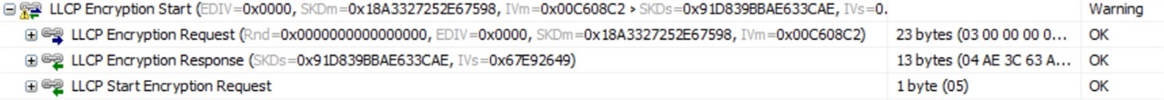

Everything seemed to go well, but the LTK only successfully decrypt my sniffer packets at the 1st time. And I track the LLCP packets, it show the complete 5 packets as following:
(Actually, this picture is not the 1st time's sniffer packets, because I forgot to save its file... but I'm quite sure these packets are like that)
LLCP complete 5 packets
Their opcode are LL_ENC_REQ,  LL_ENC_RSP, LL_START_ENC_REQ, LL_START_ENC_RSP, and  LL_START_ENC_RSP. And I use the LTK which I get from sec_info_request_process() , it can decrypt the packets.
But when I try to test again and again (refresh the code, unpair and delete bond), the LLCP packets didn't get the LL_START_ENC_RSP from central (nRF Connect), which means it only has 3 incomplete sequence as following:
LLCP_incomplete_3_packets
now I cannot decrypt the packets with the LTK. I guess the LTK may be wrong, so the central won't send the LL_START_ENC_RSP to nrf52840.
Could you please tell me what can I do now?

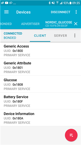

    Then I tab the "Read Characteristic" or "Enable CCCDs", nrf52840 didn't started to encrypt. So I tab the DISCONNECT, then tab CONNECT on nRF Connect, it started to run the encryption and prints the following log:
    nRF connect Disconnect
    From the log, it seemed to generate 2 times LTK?

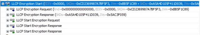

    And I track the sniffer packets by Ellisys, it really needs 3 keys, 1st is generate right after bonding, 2nd and 3rd are generated right after encryption. The following picture is what I mention 3 keys:
    3 keys
    I wonder bonding need any key to decrypt? Is that DHKey or something?
    After encryption, I only got 1 LTK in  p_enc_info->ltk[] in sec_info_request_process(), but this LTK is not applicable on 2nd and 3rd. So is this LTK correct?
    Question 4:
    LLCP packets still not get the LL_START_ENC_RSP from central (nRF Connect), so is it normal behavior?
