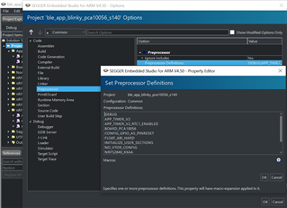

  • Hello Sam,
    The only difference being that the tx function seemed to send data successfully, but the nrf_drv_twi_rx function that passes those same parameters was returning a wild error while trying to read the acknowledgement.
    Could you make sure to pass the returned error code to an APP_ERROR_CHECK, and make sure that you have DEBUG defined in your preprocessor defines - like shown in the included image?
    Enabling DEBUG in your preprocessor defines makes the APP_ERROR_CHECK write a detailed error message to the log, before the device is reset.
    Please do this, and post the entire debug message, so we may look into what's the root issue here.

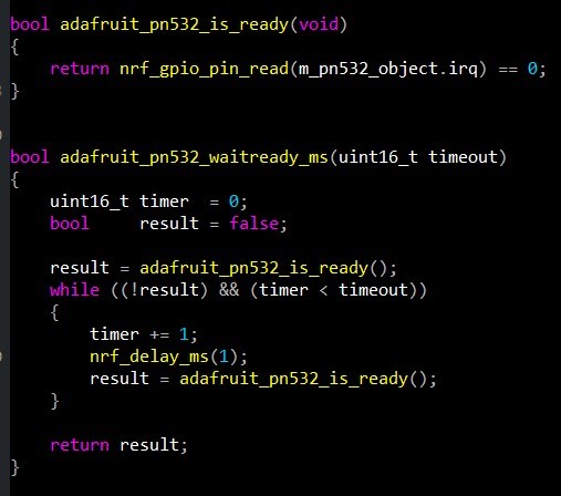

  • Thank you Karl, apologies for taking a bit on the replay. I did as you instructed and got the following error check message.
    I also ran the SCL, SDA, and IRQ pins through a logic analyzer and can see that the message was indeed sent as well as acknowledged it seems...?
    This seems to confirm an earlier suspicion I had that it may be the IRQ pin that is causing this issue, but your guess will definitely be better than mine, and I'm still not sure how I'd go about solving this. Let me know if there's other info you need, your help is much appreciated.
    Sam

  • Could you check that the address you are trying to read in the rx command is exposed in the slave device?
    I'm not totally sure how I'd go about confirming whether the address is exposed? I've found that the twi_scanner example finds the device at 0x24, which makes sense given the address parameters in adafruitPN532.h .
    #define PN532_I2C_ADDRESS   (0x48 >> 1) ///< Address of the I2C peripheral of the Adafruit PN532 Shield.
    Does this answer this question as well? I'm not sure.
    Could you check that the address you were trying to access here was in fact valid?
    As far as the IRQ pin, from the trace it seems to be staying high when, I was under the impression it needed to read a 0 for the firmware to pick up the acknowledgement. Honestly though that is just an estimated theory that I gathered from these functions that get called the init function.
    I want to be clear that this was my best guess, I don't want to spin off in a wild goose chase.
    Thanks again for your help,
    Sam
    This too will be detailed in the modules datasheet - what the IRQ is used for, and how it is used.
    From the code you have shared, I suspect that the IRQ is used to indicate that the slave is ready to transfer data, or receive commands.
    Please see if you can find the datasheet, and these two sections in particular. You may also post the datasheet here for me to take a look at it - but I highly recommend that you familiarize with it on your own first. Navigating the datasheet is essential to all microcontroller programming.
