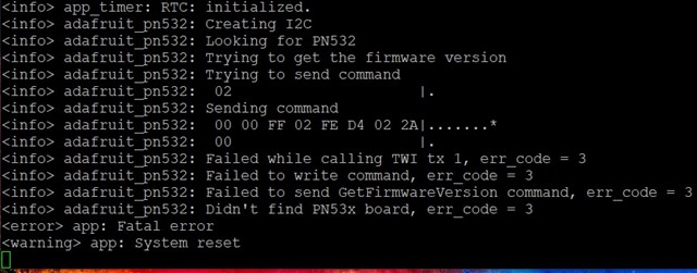

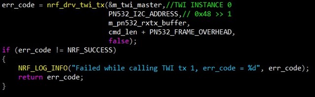

I have the Adafruit PN532 Shield v1.3 mounted to an nRF52840 DK, trying to run the ble_nfc_pairing_reference_c example from SDK 17. With no modification to the example code, I was getting the following output.
After some debugging I found the error was returning from the nrf_drv_twi_tx function with these default arguments passed.

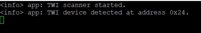

To investigate, I flashed the twi_scanner example and successfully found the PN532 at address 0x24.

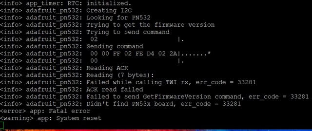

Since this doesn't match the PN532_I2C_ADDRESS being passed in the nfc reference example, I changed (0x48 >> 1) to (0x24). This resulted in the following output.

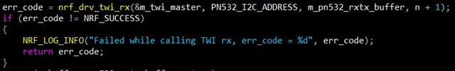

The only difference being that the tx function seemed to send data successfully, but the nrf_drv_twi_rx function that passes those same parameters was returning a wild error while trying to read the acknowledgement.
Since I was getting two different error scenarios, I re-extracted a fresh SDK 17 and tried again, but the exact behavior occurred. Does anyone know what is going on here?
My theory is that either there is something wrong with the Adafruit hardware, or these parameters are not configured correctly, unless I'm missing something.

    However, if I'm following the instructions per the Nordic SDK documentation for this NFC ref example, it should really work without much tinkering if I'm not changing anything in the code... either that or your SDK documentation should be updated to say that this example doesn't work in all cases. Indeed, it does not seem like this pn532 library was written correctly if I can't simply compile and run this example with fresh hardware out of the box. Please, if you are able, look into replicating this example and see if you experience any similar issues.

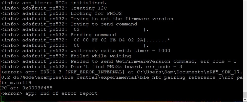

    Just to summarize; you are following the setup and testing documentation for the Experimental: BLE Pairing Using NFC - Central Reference Example from the nRF5 SDK v.17.0.2, and it seems that the IRQ of the PN532 never goes low again after the first transfer, indicating that the PN532 is not ready for the following rx transfer. As I understand it, this issue becomes apparent when the device is powering on - without needing any input (such as button presses) from you, correct?
    Could you check how many times the loop in adafruit_pn532_waitready_ms is executed, and confirm that it moves on from the loop as a result of the 'timeout'?

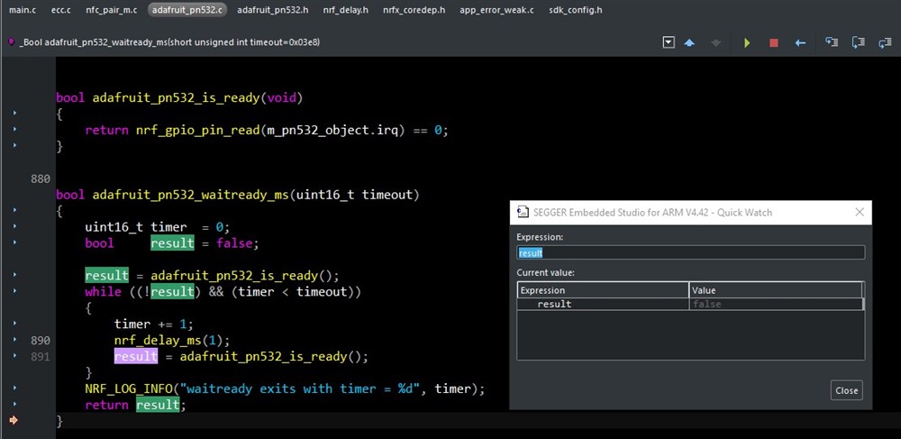

    Looking at the waitready_ms function closer, it seems to get called each time with a 1000 (1 second) value passed to it, and indeed it does exit the loop having timed out of this value.
    As you can see above, I've stopped the debugger after it exits the loop, RESULT is still false, and TIMER equals TIMEOUT of 1000. Note my debug message on line 893 and the corresponding output below which confirms this.

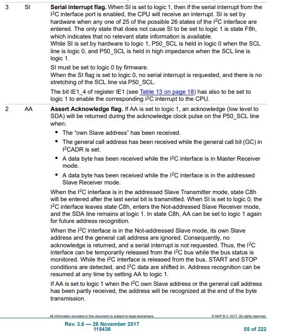

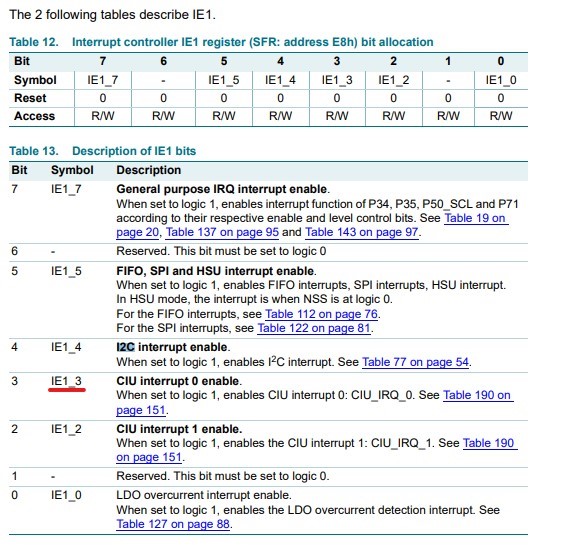

    I've also been pouring over the data sheet as well, searching for a reason the IRQ pin is not being set to 0 when it should be. I'm not sure where in the firmware these sections would apply, but could it be possible the I2C configuration is not setup for interrupt requests? I've attached some clips of the datasheet I feel are relevant here but honestly it's sort of a last ditch effort.
    Has there been any word from the developers of the adafruit_pn532 library? Is there any way I can retrieve  info from the I2C registers to see what might be happening when the NACK is received? Pages 58-63 of the datasheet contain I2C transmitter status codes with scenarios and descriptions, I'll keep working on it but again, a bit at the end of my rope on this.
