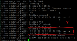

The only difference being that the tx function seemed to send data successfully, but the nrf_drv_twi_rx function that passes those same parameters was returning a wild error while trying to read the acknowledgement.
Since I was getting two different error scenarios, I re-extracted a fresh SDK 17 and tried again, but the exact behavior occurred. Does anyone know what is going on here?
My theory is that either there is something wrong with the Adafruit hardware, or these parameters are not configured correctly, unless I'm missing something.

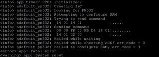

    Just to check, could you try to comment out line 263 through 273 of the adafruit_pn532.c? This section only attempts to retrieve the firmware version of the PN532, to confirm that it is connected and responding as intended.
    Unfortunately it seems the SAM config command (or any command) indeed times out as well.
    Although I did  notice the IRQ dropping a few hundred uS after the command is sent, but only on every OTHER system reset cycle. Every other cycle the IRQ still refuses to come down at all.
    Not sure if this was helpful, not wanting a goose chase here but it seemed odd.

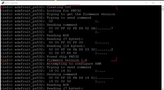

  • UPDATE: Big breakthrough here.
    Out of curiosity I flashed the adafruit_tag_reader example from SDK 17 and the PN532 communicates effectively with the 840. I can see the waitready_ms() function operate properly because the IRQ comes down about 225uS (the delta between my red cursors below) after a command is sent and the ACK is actually picked up.
    So the important discovery here is that the PCA10040 support for this example is where I was going wrong because the adafruit_tag_reader example will only function properly on my 840 DK with the PCA10056 supported example. When I flashed the adafruit_tag_rader example with the 10040 support, I got identical errors as we've been discussing. So I'm afraid I must take some responsibility in not knowing that this was actually more of a hardware selection issue. I wasn't aware the difference in board support could cause issues such as this, I've run plenty of Nordic SDK examples with different boards (for testing only, not production) and have had no major issues such as this. Big whoops on my part.

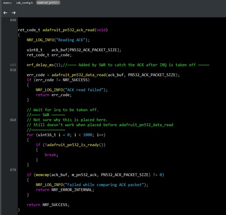

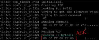

    Furthermore, I was able to get the 840 to successfully pick up the ACK from the PN532 by adding a 1ms delay to the adafruit_pn532_ack_read.
    Although I can observe the program does indeed move on from the waitready_ms and the cmd_send function that we've been discussing, I seem to be getting a brand new issue that may require a completely different ticket. I'm still stuck in the adafruit_pn532_init because no matter what command is sent to the PN532, it simply dumps 0x80808080808080 as its response (despite the ACK after the command).

    UPDATE: I went back to the s132 and the PCA10040 supported example for the nfc pairing.
    1. Extract fresh SDK 17
    2. Compile micro-ecc libraries
    3. Erase DK
    4. Flash S132
    5. Modify PN532_IRQ and PN532_RESET to pin 35 and 36, respectively in the sdk_config.
    6. Add 1ms delay to adafruit_pn532_ack_read as pasted above.
    7. Flash the PCA10040 supported example in Segger Embedded Studio.
    Result it the ACK is successfully picked but the PN532 continues to dump 0x80 continuously as its response to ANY command. I've tried commenting out the Get-Firmware command, but the SAM config command still gets 0x80 as a response data, which is incorrect and causing an error.
    Great to hear that you got it to work! It sounds strange to me that you need to insert a 1 ms delay to get it to work, however.
    What happens if you do not have the 1 ms delay in place? Is there an error generated, or is it the same behavior as we have seen before with the IRQ staying high?
    This seems like a new error indeed, but I cant help but think it could be related to the previous issues somehow..
    When you tested this with the adafruit_tag_reader example, did everything work as intended then? Did the board respond anything else than 0x8080808080?
