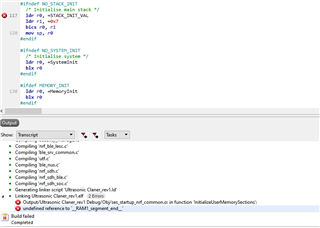

I'm working on sdk v17, and I copied the previously created project to sdk in the new path. (to use some of the functions of the previous project as they were)
And when I modified and build the project, the first error I saw was printed.
This error is output from 'ses_startup_nrf_common.s'
Output/Ultrasonic Claner_rev1 Debug/Obj/ses_startup_nrf_common.o: in function `InitializeUserMemorySections':
undefined reference to `__RAM1_segment_end__'
Can I know the cause and solution of this error?
Thank you!
    This is related to a change in the MDK package that is distributed with this release. From the release notes:
    Compatibility of SES projects:
    Updates and fixes in the MDK used by Segger Embedded Studio break backwards compatibility
    with old SES project files.
    To use old projects in combination with this version of the SDK (MDK),
    make the following updates:
    1. In the flash_placement.xml file:
       MemorySegment name must be changed from "RAM" to "RAM1":
       <MemorySegment name="RAM1" start="$(RAM_PH_START)" size="$(RAM_PH_SIZE)">
    2. In the .emProject file:
       In "linker_section_placements_segments" you must refer to "RAM1", replacing "RAM":
       linker_section_placements_segments="FLASH RX 0x0 0x100000;RAM1 RWX 0x20000000 0x40000"

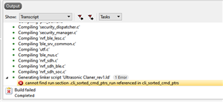

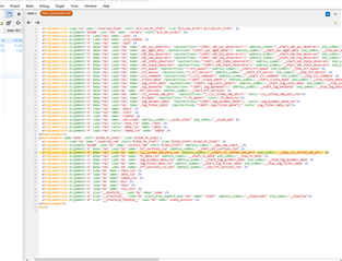

    As you said, I modified both RAM to RAM1. However, a new error printed as shown below.
    cannot find run section .cli_sorted_cmd_ptrs_run referenced in cli_sorted_cmd_ptrs
     flash_placement.xml
    .emProject
    Can I know about this?
    Thank you!
    Please make sure you have the defined the "cli_sorted_cmd_ptrs_run" section i RAM as shown below:
    Note: it must be placed in between ".nrf_sections_run" and "nrf_sections_run_end"
  • Please try to re-build the project with the XML attached below and see if you get the same error.
