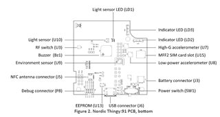

Hi Alejandro,
Please refer to the Thingy:91 documentation.
You can see that it already have LEDs and a Buzzer on-board:
However if you want connect something else over some GPIOs there are some that are externally available.
Check pin maps for more information

The nrf52840 works as a board controller on the board, so the nrf9160 communicates with the nrf52 and can therefore get the information from those GPIOs routed out of the nrf52.
(If you refer to the physical switch on the PCB that is only for routing either to nrf52 or nrf91 with regards to flash/debug)
