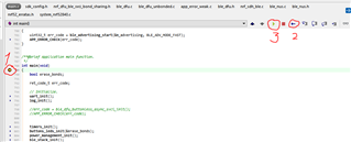

    Regarding your approach 2:
    Can you please try to run your commands (nrfjprog) first, and then attach the SES project, set a breakpoint in the start of main.c, and then reset the device using the UI:
    Is the breakpoint reached then?
    If so, what happens when you press resume again?
    Do you see anything in the debug terminal? If not, what is your NRF_FPRINTF_FLAG_AUTOMATIC_CR_ON_LF_ENABLED in your application's sdk_config.h? Can you try to set it to 0? If you need to perform this change, remember to generate the bootloader settings file again after you have compiled.
  • Hey Edvin,
    I did what you mentioned and I cannot get the device to reach the Breakpoint at the beginning of main.c. I have included my code that programs the device for reference.
    Regardless of which nrfutil settings generate function I use (between the commented and uncommented options in the code snippet below), whenever I Attach Debugger in SES, I am brought to the file 'nrf_log_frontend.c', specifically to the func: int32_t nrf_log_backend_add(nrf_log_backend_t const * p_backend, nrf_log_severity_t severity).
    When I click the RESTART button to restart the Debugger, it never goes to the Breakpoints that I set in main.c and just goes straight to nrf_log_backend_add(). Nothing is printed to the Debug Terminal.
    This may be because of a small but important detail when debugging with a bootloader. The bootloader will check the integrity of the application, and only start it if it is valid  (hash remains the same). So if you want to keep the bootloader in place but debug while modifying the application code, you need to change the bootloader so that it does not check the application hash. I recommend you simply modify crc_on_valid_app_required() in <SDK>/components/libraries/bootloader/nrf_bootloader.c so that it always returns false and flash that bootloader. Then you can debug your application as expected even though the bootloader is present and runs first. Note that you still need to flash a bootloader settings page initially or do an initial DFU update to flag that a valid app is present, though.
  • Hi there Einar, thanks for your help with this. I finally was able to Debug and found the point at which my program is breaking! THANK YOU! In general, should I keep the changes made to nrf_bootloader.c for future development/debugging? Or should that quick fix be undone moving forward?
