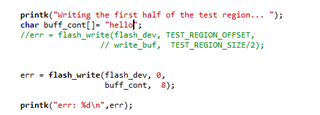

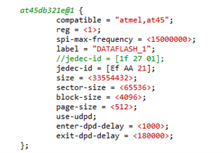

    Thank you for the explanation. My flash memory is spi flash W25N01GV. I just wanted to check whether I am sending any signal to external flash via bluetooth. I used spi_flash_45 sampke and change the jedec id of dataflash 1 to my devices' jedec id, I used scanquad to control the signals also connected the device to nrf9160 however I am not getting any signal, in the terminal it says that flash isn't found. What should I do in this case? How can I add this device to overlay file maybe I am doing that part wrong.
    Thank you for your help
     I copied the proj.conf, overlay and main code of the spi_flash_45 to hello world sample and modified the parts that I have sent.

     Drivers in Zephyr are initialized before the application starts. If anything goes wrong during the initialization, get_device() will return 0.
    In this case, the problem is probably that you are using a W25N01GV, while you try to use the driver for an AT45DB321. These two devices are not compatible, so you will need to use a driver for the W25N01GV instead of the AT45.
    Unfortunatly, it does not look like there is a driver for the W24N01GV in NCS. You will therefore have to create one yourself.
