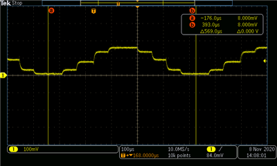

I am working on a project in which the ultimate goal is to read an 8-bit signal with 10kHz frequency.
To test if this would be possible, I tried to generate a digital signal using a timer. The timer is configured as below:

But when I measure the generated signal using a DAC and an oscilloscope the frequency of the signal is as seen in the next image:
The achieved period is of 569us, which gives a 1.757kHz frequency.
I saw in other tickets people saying that GPIO frequency can go up to 16Mhz. Then, why can't I generate a high-frequency signal?
    as I understood from oscilloscope screenshot, you have a 57-us interval between GPIO switching. I think sprintf() and SEGGER_RTT_WriteString() eat most of these 57 microseconds, try to comment them out. To achieve maximum frequency, use HAL module functions (nrf_timer.h) instead of nrf_drv_timer, and write an irq handler (as short as possible) by yourself.

    Just by removing the debugging functions I already noticed a 5x improvement in the frequency. I wrote the code based on the examples found in the nRF5_SDK_16. There, they use the functions in the nrf_drv_timer for timer initialization. Would you know where I could find examples of timer initialization using the functions in the nrf_timer.h?
  • You can look at source code of Contiki-NG timer module. If you're using BLE stack, you'll need to configure other timer instance because TIMER0 is occupied by SoftDevice.
