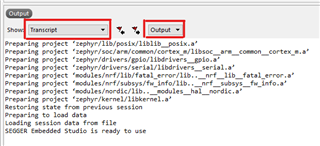

  • I tried to update the proj.conf file through Segger's Configure nRF Connect SDK Project window in SES.  However this fails to load the menuconfig.  I just get the non descript error create_nordic_project.py failed (1). Struggle to figure out how to proceed.   The project loads and builds fine.  But I can't seem to alter any of these project settings to get it to work properly.   I've reinstalled nRF Connect SDK 1.4, and SES, but no luck getting past this point.
     Did you get any output in the output window?
