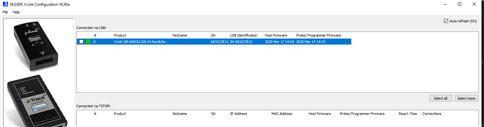

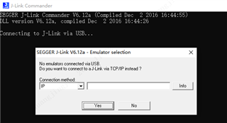

    According to your prompt, I check the jlink configration and update its firmware. It seems to be OK, but the chip still can’t be connected by jlink. The Programmer and jlink show this:

  • It seems that the chip went into a state that it is not able to recover.
    I assume that you succeed to connect to the device using J-Link Configurator but unable to connect it using J-Link Commander (based on your snapshots)
    You can try to use the nrfjprog to recover the chip as the last resort.
    In the normal command line, just type
     > nrfjprog --recover -f nrf53
