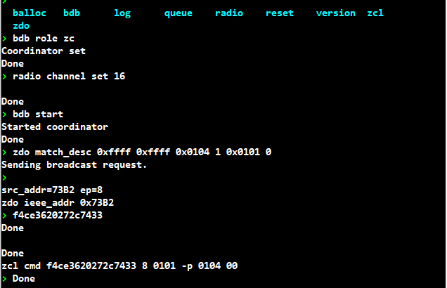

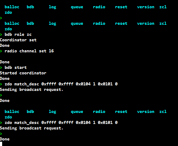

and I setup the coordinator following commands.
and, I execute command to get door lock address following a pic.
But, It can't find the door lock.

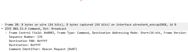

I checked RF channel and zigbee data in same channel via sniffer.
The coordinator obviously send request match_desc data.
But, the door lock just send beacon request not response.
