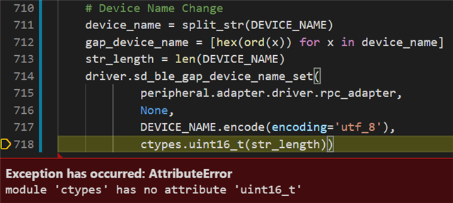

In my script, the function is used as follow:
    # Device Name Change
    device_name = split_str(DEVICE_NAME)
    gap_device_name = [hex(ord(x)) for x in device_name]
    str_length = len(DEVICE_NAME.encode(encoding='utf_8'))
    driver.sd_ble_gap_device_name_set(
            peripheral.adapter.driver.rpc_adapter,
            None,
            DEVICE_NAME.encode(encoding='utf_8'),
            str_length

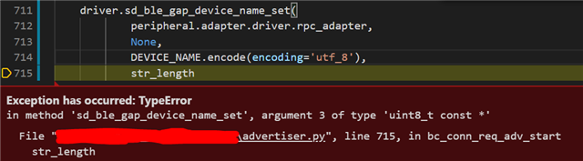

when in Debug mode with Visual Code, I receive this message:
Can anyone help me to solve this issue?
Thanx,
Fabio
  • Hello Fabio,
    What is the type of your passed str_length variable?
    As you see in the sd_ble_gap_device_name_set the len parameter needs to be of type uint16_t, while then python len functions returns an int ( represented by 4 bytes ).
    I assume this is why you have got your type error.
    Please try to typecast the len variable to uint16_t, and see if this resolves your issue.
    Karl

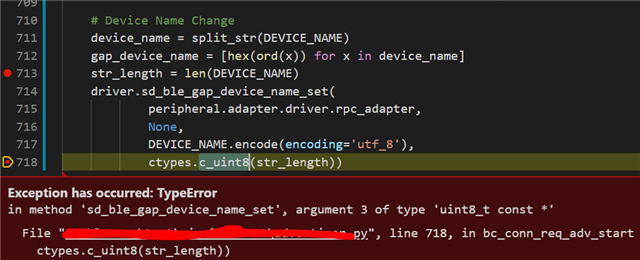

  • Hello Karl,
    Yes, the str_length variable is of course an int.
    The variable DEVICE_NAME is a string "HelloWorld", which is converted and stored in device_name as ['H','e','l','l','o','W','o','r','l','d']
    Googling around there's the ctypes library which seems to have only ctypes.c_uint8 and ctypes.c_uint16, but no c_uint8_t or c_uint16_t. Trying to import ctypes library and using c_uint8 or c_uint16 it in my code, the answer is the same:
    Is there a better way to make a change name on the device?
    Thanx
  • Hello again Fabio,
    Fabio Ballanti said:
    I finally solved it in a simpler and more reliable way, without any conversion:
    Great, I am glad to hear that! This is exactly how the pc-ble-driver-py is intended to be used - no need to look into the C functions running behind the scenes.
    I hope my explanation of this in my last comment was helpful to you.
