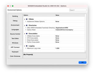

Update on this. In my case the issue was that I had not updated the paths correctly (after moving things around). Perhaps you did the same, or forgot to set zephyr and toolchain base in the first place?
Before opening a NCS project you need to start SES, then go to Tools -> Options ... and select nRF Connect. Then you need to set the two Directories correctly. In my case it is like this, but you need to adjust it for your setup:
After that, you should be able to open a NCS project from File -> Open nRF Connect SDK Project...
