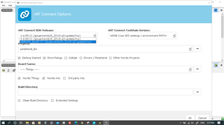

  • What are your options under "nRF Connect toolchain version"?
    Carl Richard
  • Hi again!

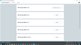

    From what I can see there are something wrong with your installation as you aren't seeing the corrects paths and options. I also find it a bit weird that gnuarmemb is your specified installation directory.
    Could you try to remove the installed NCS version again, then go to "Settings" in the Toolchain Manager app and change your installation directory to something like this "C:\nordic\ncs" before trying to install again?

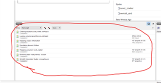

    Also, when a build in SES fails you are able to see the build log by double clicking at the field in the image below:
    If any more errors happen, pleas provide that log to me.
