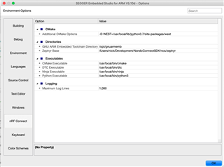

  • I see. I'm quite unsure regarding what may be causing this. While I can't manage to reproduce it, I believe it may be related to the YAML issue of earlier. However, you could try to add the nrfx.h file manually (Project -> Add existing file)  and ensure that it's correctly set in menuconfig (Project -> Configure nRF Connect SDK project -> Search for HAS_nRFX).
    In addition, could you also post a screenshot of how the nRF Connect SDK is configured in SES. You can find this under Tools -> Options -> nRF Connect SDK.
    We've just updated the Toolchain Manager of nRF Connect for Desktop to be more stable for MacOS users, so I recommend trying that if the above is unsuccessfull.

  • Hi again, Nick!
    I did some more digging and from what I can see SES can't find west on your path. The build log should normally show "found west", but I haven't seen that in your logs. You can read more about the issue in this thread.
    Remember to put define the path to the west executable in Additional CMake Options as explained in the manual installation guide.

  • CMake West path already added.  West exists in this location and west runs OK from terminal...
    Still getting nrfx.h error...

  • I see.
    What is the version of the Python executable is present at "/usr/local/bin/python3"? That is the standard location for Python installed through "brew", which should be 3.9 from what I know. However, your west package is installed for 3.7. That could maybe pose a problem.
