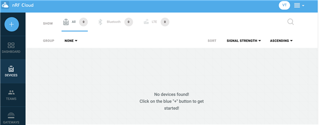

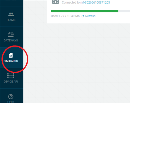

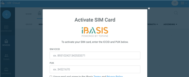

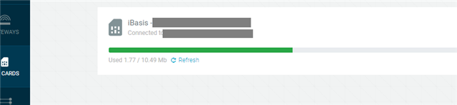

    Once I found the option for checking the SIM card (my window had been too small) I saw that it was not activated, maybe due to some issues with nrfcloud.com 2 days ago.  It is now.

    Now when I click reset on the device and wait a while I still don't get any LEDs.
    (The SIM card pages says "Not connected to any device".)
    (and the device is not provisioned.)
