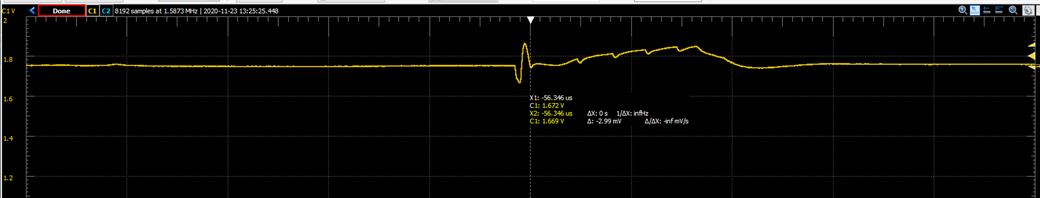

We have a custom board designed using the ublox Anna B112 module which uses NRF52832. We are using it in open CPU mode and running our custom firmware.
The VDD is 1.8V in our case. Whenever I have tried to enter deep sleep mode via
sd_power_system_off() OR
nrf_power_system_off() OR
nrf_pwr_mgmt_shutdown(NRF_PWR_MGMT_SHUTDOWN_GOTO_SYSOFF) OR
NRF_POWER->TASKS_LOWPWR = 1; NRF_POWER->SYSTEMOFF = POWER_SYSTEMOFF_SYSTEMOFF_Enter;
The system resets right after. The RESETREAS register reads zero, suggesting that a power on or a brownout reset. I understand that 1.7V is minimum operational voltage.  My questions are:
1. How long does the VDD need to drop below that to trigger the reset?
2. How do I troubleshoot this issue? I have probed the VDD line using an oscilloscope have noticed a drop close to 1.7V for about 20 uSec.
I have reviewed all the threads on the forum on this issue. Ensured that the test is not in Debug mode, power cycled the unit, added an infinite loop after the call.
