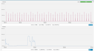

    It's hard to say if the problems you observing are related to FW, HW, or both. To try narrow it down, I would suggest you try to measure current with my 'ble_app_template_260325' project attached below, and see if you can get similar results with your setup as I got when I measured it here.
    To begin, the led 1 of the board begins to blink as if it were in advertising mode and we have set an APP_ADV_DURATION of 2000, however it blinks infinitely. But when we try to search it with the Nordic nRF Connect application, the device does not appear.
    Ok, so the advertisment will time out after 20 seconds of advertising. However, the LED indication for advertising is started on BLE_ADV_EVT_FAST by calling the bsp_indication_set(BSP_INDICATE_ADVERTISING), and it will not stop until the app calls bsp_indication_set() with a different indication state (see BSP indication states). In other words, it's the application that's responsible for changing the LED indication when the app stops advertising. Otherwise, the LED will keep blinking forever.
    Measurements results with ble_app_template_260325 and nRF52DK
    Advertising mode
    Connected mode (~180 ms connection interval)
    Attachment (Requires nRF5 SDK v17.0.2)
    1033.ble_app_template_260325.zip

    I want to thank you for your prompt response, I have tried the program and it works like a charm, in advertising mode it consumes a maximum of 90 uA, varying up to 5 uA, and in connected mode it varies from 5 uA to 43 uA, what is the reason for this variation?

    Then I had removed that line and that was causing the problem, when I put it back the program works as expected. However, there is still a current consumption of 267uA, which is possibly due to BAS or because we are using a PWM pin, any idea will be appreciated. In my project the consumption is stabilized at 267 uA but in the one you send me there is a continuous variation, why does this happen?
