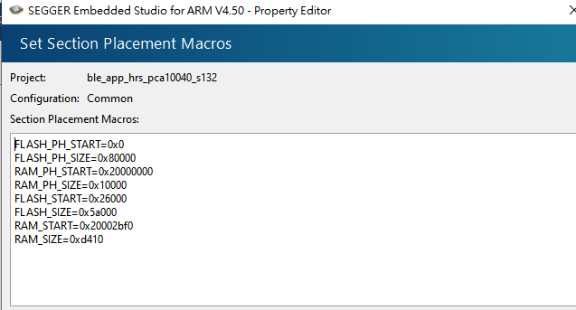

ble_app_hrs + Buttonless DFU on NRF52DK(52832) + OTA update
I want to verify
1. Program  ble_app_hrs with buttonless dfu integrated + secure bootloader + bootloader setting to nRF52DK.
2. Boot up nRF52DK, then use buttonless dfu goto bootloader mode
3. Update app_dfu_package.zip (nrfutil pkg generate --hw-version 52 --application-version 0 --application ble_ap nrfutil pkg generate --hw-version 52 --application-version 0 --application ble_app_hrs_pca10040_s132.hex --sd-req 0xCB --key-file private.key app_dfu_package.zip
Zip created at app_dfu_package.zip)
Below are my steps:
Step1 Generate bootloader setting page
Step2  merge secure bootloader(\dfu\secure_bootloader\pca10040_s132_ble\) + bootloader settings
Step3 Program secure bootloader (examples\dfu\secure_bootloader\pca10040_s132_ble)+ bl setting
Step4 Program softdevice (s132_nrf52_7.0.1)
Step5 Program app(ble_app_hrs_pca10040_s132 which is integrate with buttonless_duf already)
Step 6 When nRF52DK bootup, error logs are below:
Are my steps correct?
How can I make it right?
Thanks.

  • Hi Vick
    It seems that you got the error because the peer manager was not initialized before the buttonless service init (ble_dfu_buttonless_init() ).
    If you have a look at the ble_app_buttonless example you can find that we call peer_manager_init() before we call service_init() (which call ble_dfu_buttonless_init() ) when in ble_app_hrs it's not the case.
    Please try to change that and let us know if you still have the issue.
  • Hi Hung
    It works, the device goes to advertising now!
    After that, I'm trying to do DFU, but meet some problem.
    Please see below.
