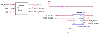

    Could you please share how you have connected the two devices? A connection schematic would be helpful, to rule out incorrect connections.

    I'm checking on debug UART port with PuTTY terminal and also added m_rx_buf[] in watch window. Not had access to logic analyzer.

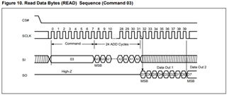

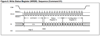

    The datasheet for the MX25L6433FM2I-08G says, for write/read operation sequence should be as:
     Write Status Register (WRSR): The WRSR instruction is for changing the values of Status Register Bits and Configuration Register Bits. Before sending WRSR instruction, the Write Enable (WREN) instruction must be decoded and executed to set the Write Enable Latch (WEL) bit in advance. The WRSR instruction can change the value of Block Protect (BP3, BP2, BP1, BP0) bits to define the protected area of memory (as shown in "Table 1. Protected Area Sizes"). The WRSR also can set or reset the Quad enable (QE) bit and set or reset the Status Register Write Disable (SRWD) bit in accordance with Write Protection (WP#/SIO2) pin signal, but has no effect on bit1(WEL) and bit0 (WIP) of the status register. The WRSR instruction cannot be executed once the Hardware Protected Mode (HPM) is entered.
    The sequence of issuing WRSR instruction is: CS# goes low→ sending WRSR instruction code→ Status Register data on SI→ CS# goes high.
    The CS# must go high exactly at the byte boundary; otherwise, the instruction will be rejected and not executed. The self-timed Write Status Register cycle time (tW) is initiated as soon as Chip Select (CS#) goes high. The Write in Progress (WIP) bit still can be checked out during the Write Status Register cycle is in progress. The WIP sets 1 during the tW timing, and sets 0 when Write Status Register Cycle is completed, and the Write Enable Latch (WEL) bit is reset.
    Read Data Bytes (READ): The read instruction is for reading data out. The address is latched on rising edge of SCLK, and data shifts out on the falling edge of SCLK at a maximum frequency fR. The first address byte can be at any location. The address is automatically increased to the next higher address after each byte data is shifted out, so the whole memory can be read out at a single READ instruction. The address counter rolls over to 0 when the highest address has been reached.
    The sequence of issuing READ instruction is: CS# goes low→ sending READ instruction code→3-byte address on SI →data out on SO→ to end READ operation can use CS# to high at any time during data out.
    Yes, this seems to be the relevant section of the datasheet.
    It seems to me that you are not following this, since you in your transfer declare the length of the transfer with m_length for both rx and tx. In your case, this is a const defined to 6, while the command you are trying to send seems to be only 1 byte, namely 0x01. So, you are effectively sending 0x01, 'o',  'r', 'd', 'i' ,'c', followed by a 6 byte read.
    Please read over the Read Data Bytes section, and make sure that your messaging is in line with the specification.
    Karl
