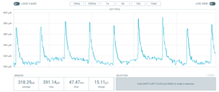

Low power mode in Zephyr
I'm using zephyr to develop a battery powered IoT device with a sensor and a LoRa transceiver (SX126x). And I'm expecting to achieve average consumption values (during "sleep" mode) around ~15uA. At this moment I can only get ~360uA. I've already found many other users with the same issue in this forum and already know that I need to deactivate the SoC's peripherals that I'm not using. The issue is that I can't find which peripherals are these, already tried to deactivate some but the results were not the expected. To ease my debug processes, I developed a small code with a similar behavior as the one to be used in the final product, which I will share here:

I could summarize my questions in:
  • Is there a better form of managing the devices in Zephyr?
  • Is there a way to know which devices are being used, and in which mode are they?
  • Or if I'm thinking right, but doing something wrong in the code?
Diogo Correia
PS: these values were measured using the power profile kit in external mode due to the presence of a shield in the development board.

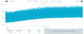

  • Hi, are you using nRF52840? I have a feeling that the extra current is a result of UART1 being turned on. All UART instances are turned on by default in Zephyr.
    Create a file called nrf52840dk_nrf52840.overlay in the project root folder and add this:
    &uart1 {
        status = "disabled";
    Unfortunately there's no easy way to see which devices are turned on in zephyr. Other than that I think your code looks good. The way you turn off logging (and hence UART0) looks fine:
    device_set_power_state(cons, DEVICE_PM_OFF_STATE, NULL, NULL);
     How do you connect the PPK? If you are measuring on a nRF52 DK and power the DK thorugh the external supply header, the idle current is expected to be high because you power the debugger chip as well.

  • Hi, sorry for not getting back to you, I missed your last reply. Were you able to figure out this? Did you get any help from the Zephyr mailing list?
  • Hi, Stian. No, I haven't figured out how to solve this issue. Any idea?
  • Hi, I'm not familiar with the SX126x driver, so I think we first need to figure out which peripherals are active. As I  understand the communication protocol is SPI? The SPI should not consume any significant current unless it's actively transmitting. Any other peripherals being used?

    Here are the plots with the device's current consumption, during sleep mode. The first plot shows the current consumption along all the sleep mode time. And, the second plot, is a zoomed view of the first one.
  • It looks like you have some leakage on the VDD domain since the base current between the spikes is so high. The varying current could be a floating GPIO input.
    I think we should first try to verify the measurement setup. If you put the chip to system OFF mode the chip will consume less than 1uA. If you still see a high current there will be other things connected to the VDD that consumes current, or you have leakage through the GPIOs (if configured as output). Make sure that the pins controlling the LoRa module are set to a defined level before entering system OFF mode so that the LoRa module does not consume current (typically the chip select pin).
    You said that you use the PPK in external mode, because of a shield. Does that mean that you are measuring on a DK? Which DK is this (PCA number and version)? Can you also please explain how you set up the PPK for measurements. If you connect the PPK directly to the external supply header on the DK you will be measuring the debugger on the DK as well.
