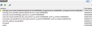

    While debugging I got breakpoint error. I am sharing that please see. Kindly have a look and respond asap. Thanks.
    So you're getting an assert in the UART event handler, which would explain why don't see the board advertising. Are you sending any data? Could you try setting a breakpoint in the handler and see exactly what function call that causes it to assert?

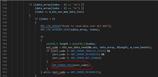

    My guess is that it asserts here:
    Could you verify it by setting a breakpoint there and see what the error code is.

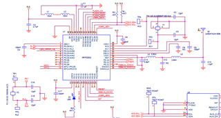

     I don't know why breakpoint is coming. I didn't send any data. I am only trying to advertise Bluetooth with BLE UART code. I am using reference design from NRF52 series. Then I need to change custom board file. I am attaching schematic too. Please help us regarding. Thanks.

    The unmodified example uses pins 5-8 for the UART. These pins are not connected to anything in your custom board. You would therefore have to change the board file so that they are mapped appropriately. Or change the pins in the application.
    Also, your schematic is mostly ok. Only concern is that you're using the pins on the upper side for I2C. The pins on the upper and right side of the IC is marked as low frequency/low drive, using these pins for serial communication might cause interference with the radio signal. However, I don't think your current problem is related to this.

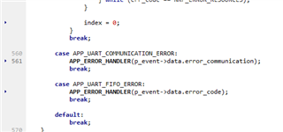

  • Dear Jared,
      After debug I got following error. I am attaching image. Please check. kindly help us regarding.Error in 561.
  • Hi.
    Seems like the issue is still somewhere in the uart_event_handle(). Try setting breakpoints in the various cases in the switch case and see where the application stops.
    Did you make a board file? The easiest is just to copy the PCA10040 board file and then adjust it to your board.
    Note: Debugging Softdevice applications requires that you restart the application each time the application starts. The application will assert otherwise i.e if you try to resume the application after it has stopped at a breakpoint. This makes it not possible to step through code step-by-step in  a SD application. See this and this thread for more info.

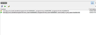

  • Most definitely not a permanent solution. If it works when you comment out that line then it means that you're getting an APP_UART_COMMUNICATION_ERROR. Try setting a breakpoint at  APP_ERROR_HANDLER(p_event->data.error_communication) and check the event structure p_event->data.error_communication, it should specify the error source.
  • Dear Jared,
      I am getting same error only if I un comment that. I am attaching that image. Please check and provide us solution .
