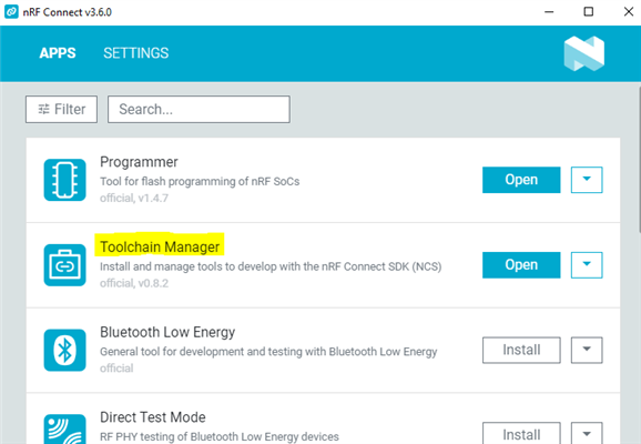

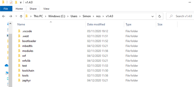

  • We are aware of this issue. The Open IDE button should present if the environment has .west/config file present at the same level where the toolchain folder is. The issue is caused by previous manual installation of NCS where the existence a higher level of .west blocks cloning the later version. The solution is to use a clean environment or to manually fix the folder stucture.
    Could you go with the workaround described above as a temporary fix? Hopefully we can find a better fix for this soon, I will keep you updated.
