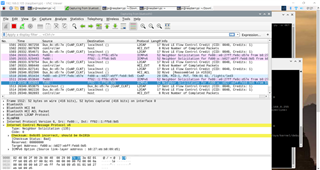

I am able to setup Raspberry as border router for BLE 6LoWPAN. I can run CoAP server using CoAPthon3 on IPv6 (including bt0 interface) successfully. I have added global/unique local IPv6 address on bt0 interface on Raspberry Pi. I am able to connect NRF52840 DK and raspberry Pi using 6LoWPAN over BLE. I have installed radvd daemon for advertising packets. It is transmitting the ICMPv6 packets but with checksum error as captured by wireshark on raspberry pi and also verified by debugging in the NRF52840 CoAP client code. So, client has not been assigned IPv6 address other than link local. As a result, when I make a CoAP request using button 1 or button 2 on NRF52840 DK, it is captured by wireshark but no forwarded to CoAP server

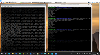

3. Checking the CoAP server by running CoAP client on Raspberry Pi terminal using same Coapthon repository (working fine - screenshots attached):
           (a) using wlan0 IPv6 localhost -  sudo python3 coapclient.py -o GET -p coap://[::1]:5683/basic -P "test payload"
           (b) using wlan0 inet6 link local address - sudo python3 coapclient.py -o GET -p coap://[fe80::fc47:97f7:14dc:aaa3]:5683/basic -P "test payload"
           (c) using bt0 link local address - sudo python3 coapclient.py -o GET -p coap://[fe80::b827:ebff:feb8:9d5]:5683/basic -P "test payload"
           (d) using bt0 global/unique local address - sudo python3 coapclient.py -o GET -p coap://[fd00:a::1]:5683/basic -P "test payload"

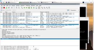

           (e) press button 1 or button 2 on to send CoAP request to the server (captured on wireshark - screenshot attached) but not forwarding to coap server
           (f) advertisement packet from radvd is showing checksum error (wireshark screenshot and NRF 52840 PuTTY screenshot attached)
