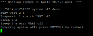

I have compiled the example application ncs\v1.4.0\zephyr\samples\boards\nrf\system_off configured for the nRF52dk_nRF52832
This example consumes 450-500uA (SB9 cut).... 100times more than I would expect. Is there no power optimization when using zephyr? Performance like this would make any project based on this source base flop or fail the say it kindly... Might I be doing something wrong or is the nRF Connect SDK this bad compared to the nRF5 SDK
