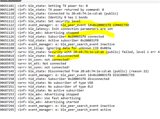

I have been working on porting the nrf Desktop Mouse to my custom hardware which includes an Adafruit_nrf52840 feather, and a PMW3360 motion sensor.
I ran the Peripheral HID Mouse example, and my Windows 10 PC recognized the ble advertisements, and connected and ran some demo mouse movements.
I need a basic setup that will allow a stable connection to one Windows PC.  Please let me know if additional information is needed.  I am getting
excited to get this working and get the demo models into production.
Dan
Case:  I am following the "Integrating Your Hardware" instructions to use the nrf Gaming mouse project.
So far, the project is building and the device can connect via USB and runs the motion sensor.  But, I am having some trouble

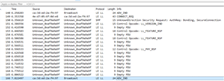

getting the BLE connection right.  I think I have not configured things properly.  The advertisements are being sent out, and I can see them on a BLE sniffer and on "nrf Connect" for Ios.
Problem_1

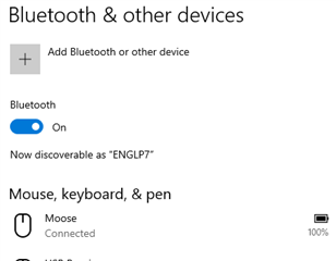

My Windows PC no longer recognizes the advertisements from the Mouse?  I think I was able to connect once to my setup, but during
testing I removed the device from Windows. The nrf52840 is advertising as shown by the BLE sniffer and my Iphone running "nrf Connect" sees them.
Problem_2
When I try to connect using "nrf Connect" on the IPhone, the connection is quickly disconnected and shows that
a security fault is the reason.
debug text during the advertisement and quick disconnect.
BLE sniffer
