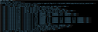

I got SPI working when writing to the CS pins directly. I thought however it might shorten the SPI acces when using spi_cs_control. When executing the code I will however get an error on the first spi_transceive:
Here is my code:

I can not find any documentation on gpio_dt_flags. Maybe spi_cs_control is just not supported for nRF9160??
Best regards
Dirk
Parents Reply
  • Hi Öyvind,
    I have added the cs-gpios to my devicetree .dts file as you can see but I dont have written a complete driver for the MC33879 and I am not sure how to add a child node without being able to refer to a driver module.like in the Thingy example "compatible=adi,adx1362".
    Never mind it is working with calling gpio_pin_set as I do now too.
    Have a nice Friday!
    Dirk
