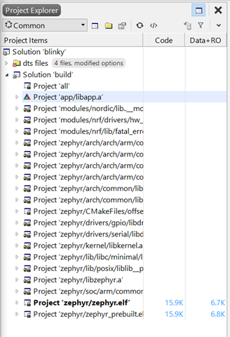

3. After a while project ES is created, but there is no entry where Options are enabled. I discovered when I tried to make changes recommented for dongle. Here is how project tree looks like
4. When built with defaults, blinky works on nRF5340, I see LED blinking. It doesn't work in case of dongle, not sure what defaults are in this case, because I don't see project options.

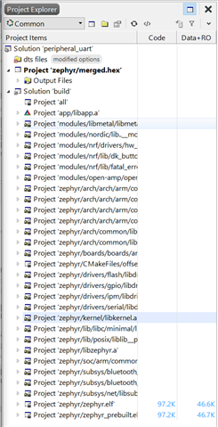

5. The only case when I see different picture is for the project peripheral_uart, here additional node is created and there are options enabled:
This project is not supported for dongle, so I cannot tell how recommended adaptation works. This was the only project that creates merged.hex.

  • Sorry, I wasn't clear enough.
    I was trying to take Blinky sample program and adapt it to the nRF52840 dongle, as explained here. But I don't see how I could do this if Options context menu is disabled on all nodes in project tree in SES, so I cannot open preprocessor definitions. Then I started opening other nRF Connect SDK sample projects and I see the same behavior with almost all samples. My understanding is that the only way to make new project is to open an existing sample and then modify it. If I cannot change preprocessor definitions how could I convert sample to what I need?
    Since initial post I installed nRF5 SDK and found that samples there could be adjusted, so I am not blocked, but still confused -- why there are 3 sets of samples with different project formats?
    Thank you,
    Sergei
  • The dongle porting guide is for the nRF5 SDKs, not the nRF Connect SDK. In nRF Connect SDK you use the nrf52840dongle_nrf52840 target.
